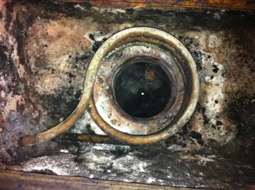

    Some more photos for you to have a look at. I think the firebox and draft doors are welded shut, and the section where the ash pan should go has a (non-working) fan - not sure if this would have been on the original wood-burning version of the stove - might make it too hot? I included a pic of the coil for the water heating just for kicks if anyone's interested.
    The yeast can is to catch oil drips (thankfully there are none, but just in case).
