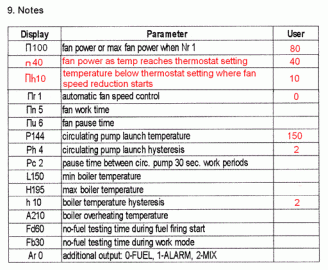

It takes some time for the tank temperature to approach the boiler temperature. I have found that, at least the way I run my boiler, modified settings on the controller can help. The idea is to slow the fire down without losing gasification when near the end of a burn and the tank temps are getting near max.
There are a couple of undocumented settings in my controller that I have tweaked to accomplish this that the attached shows. The settings I have marked in red show how I have changed the settings. Basically what happens is that when the temperature rises to 10 degrees lower than the thermostat setting, the blower begins to slow down. As the temperature rises above this point the blower continues to slow down until it reaches a couple of degrees below the thermostat setting. Also, I lowered the hysteresis setting to the minimum value so that as soon as the boiler temperature drops 2 degrees the blower starts back up.
