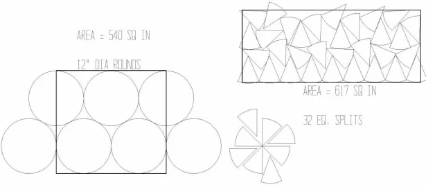

  7. edthedawg
    edthedawg
    Oct 5, 2008
    878
    2
    Northeast, CT
    I couldn't resist....

    Actually, there is quite a bit of shrinkage. I stack my wood row 9 feet high, right tight to the rafters and am amazed how much gap forms, and this after the wood sat out all summer.
    That example drawing with all identical splits is not representative of most wood piles. I usually mix up my sizes so I have a lot fewer gaps.
