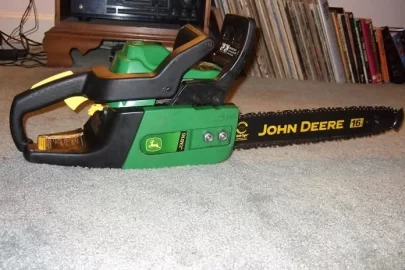

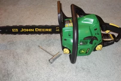

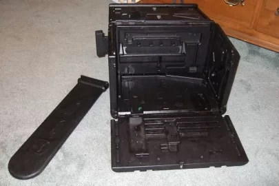

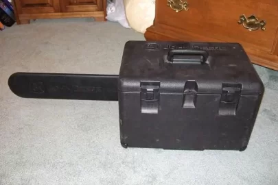

I picked up a John Deere j3816 40 cc chainsaw today. I saw someone on craigslist try to acquire a free chainsaw through the wanted section due to lack of funds, well I have a lack of funds so i gave it a try on Freecycle and. i got an email from a woman who had the saw. she said she also got it for free on Freecycle and it wasnt running. She said her husband was able to get it to run but it wasnt oiling properly. So i figure this saw is going to be OLDDD, running choppy w/ the need to replace the oiler. Well i picked it up and it was pretty much a brand new saw!!! i cant imagine it ever didnt run. it started right up but the idle speed was maxed out so the blade was continuously running. So i adjusted the idle and throttle speeds and it runs beautifully. the engine doesnt miss a beat, stumble, nothing. i still need to test it out on the field but i have very high expectations with it. the chances are it wasnt oiling properly because the speeds were maxed out and it was exhausting a lot of smoke from the ultra rich gas. it came with a nice plastic case and a great chainsaw tool.
Man, but you cant beat that price, $0. i would have been happy with a small poulan or mcCulloch or some big box cheapy.
im having trouble finding information on this saw or a manual or anything. i think it might be made by efco but im not sure??? is it a midrange saw??? probably not a pro. what years did JD sell these. i dont know where are all the chainsaw buffs. computeruser im looking in your direction ;-)

JD j3816 was made by Homelite,
oh well i guess its not an efco or echo but it'll do. between my homelite and poulan it should hold me over until i can afford a Dolmar 5100 or the likes. i found a manual online and at least this one doesnt say in big bold letters FOR OCCASIONAL USE ONLY, unlike my poulan.
btw the adjustment screws are hi carb, low carb, and idle. idle speed should be pretty easy to determine where to put it but how should i adjust the high and low carbs? thanks.
