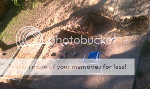

    Footings dug, and slab for the hot tub:
    [​IMG]

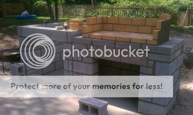

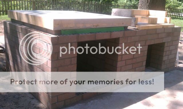

    All poured and block laid. The firebrick there is a built-in charcoal grill. The other side is reserved for an outdoor fireplace:
    [​IMG]
    First color brick laid, and base poured for the oven:
    [​IMG]

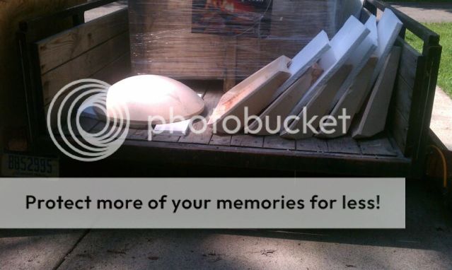

    The cast refractory pieces for the modular oven. It's from Superior Clay products:
    [​IMG]

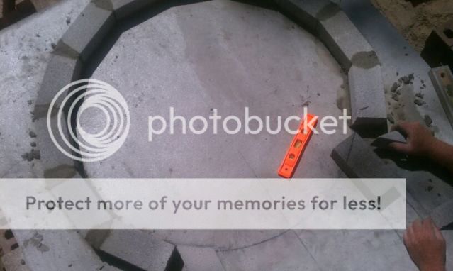

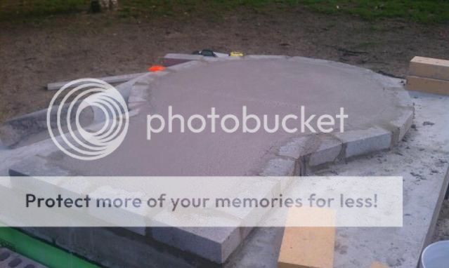

    Laying out the circle for the poured refractory clay:
    [​IMG]

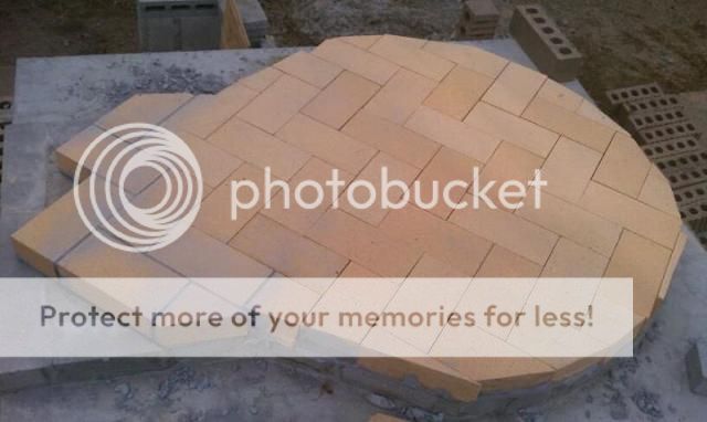

    Herringbone floor laid:
    [​IMG]

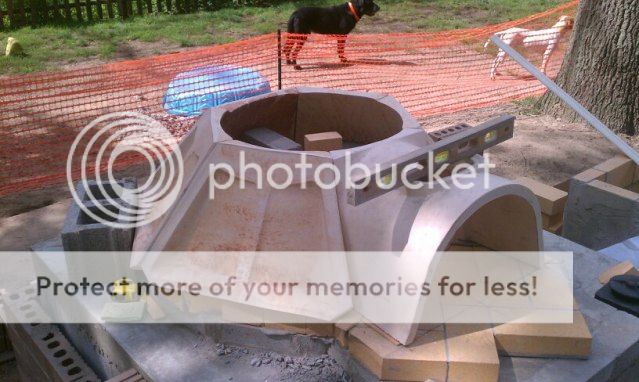

    All pieces mocked up, ready for the heat-stop mortar to join together:
    [​IMG]

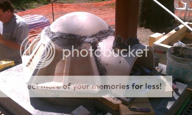

    All pieces together, and first flue in place:
    [​IMG]

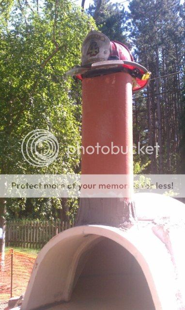

    Cousin Dave (the mason) thought my helmet from work would make a nice cap: lol
    [​IMG]

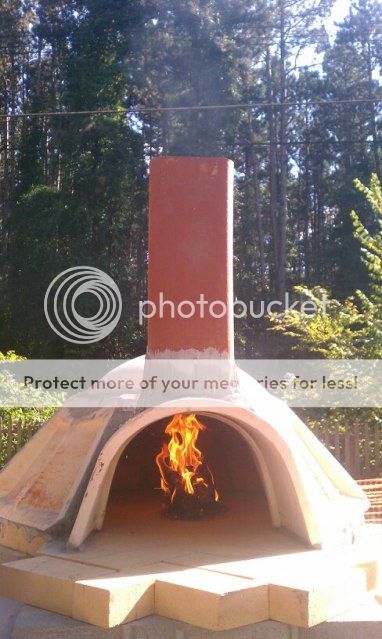

    Checking draft with a few sheets of newspaper:
    [​IMG]

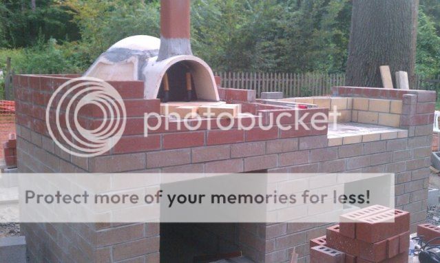

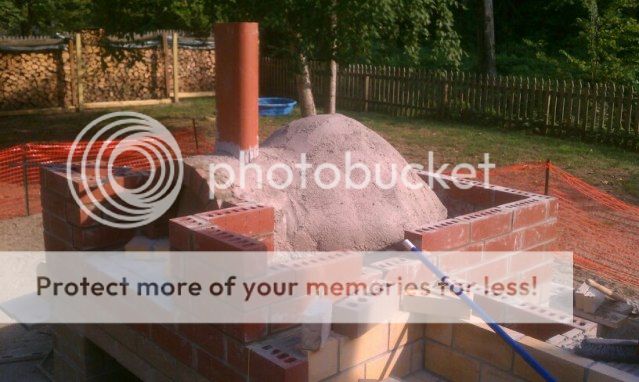

    Transitioned to the red brick:
    [​IMG]

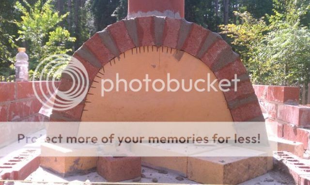

    Arch formed:
    [​IMG]

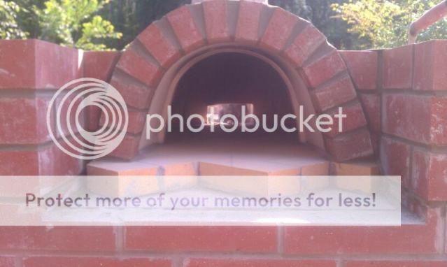

    Arch completed:
    [​IMG]

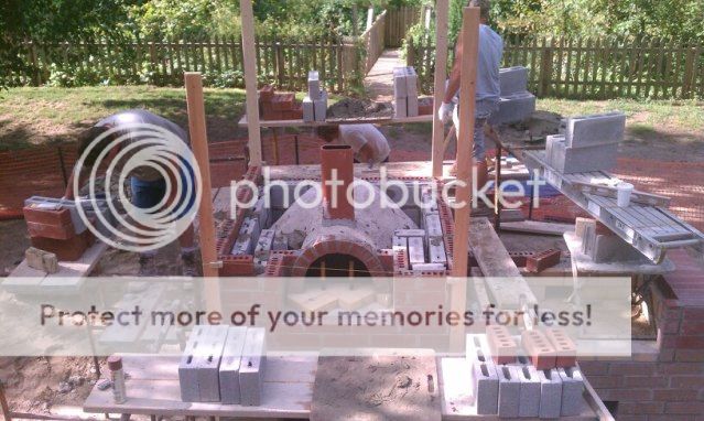

    Scaffold set up, ready to take it to the sky:
    [​IMG]

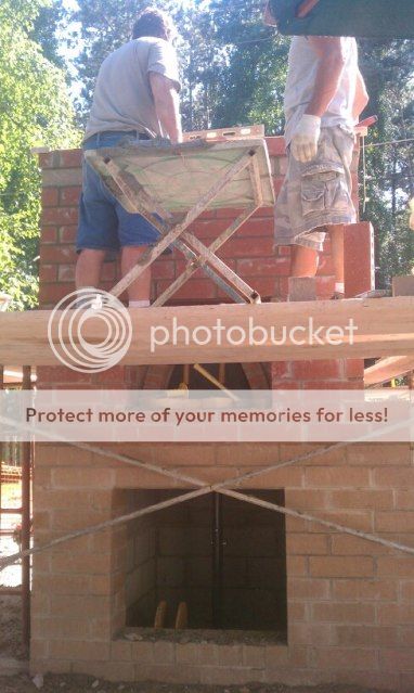

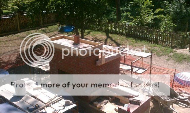

    Cousin Dave was the head of this whole project!
    [​IMG]
    Forms built, ready to pour the caps:
    [​IMG]

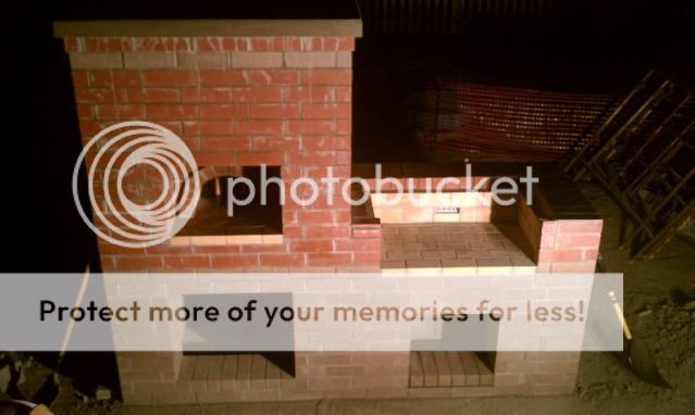

    A night time pic from my roof. All that it needs now is an acid wash:
    [​IMG]

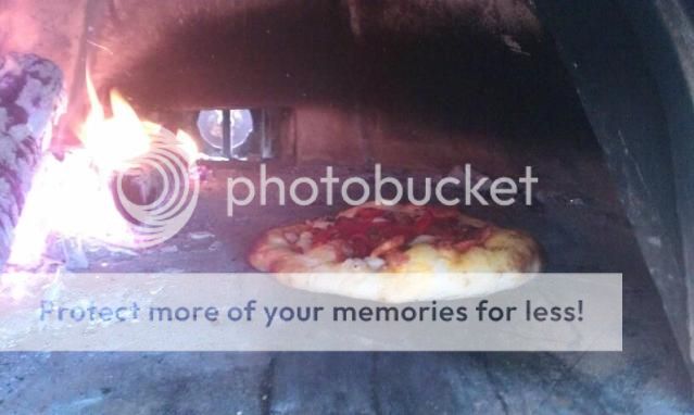

    Here are a few food shots from the first real pizza party last night:
    [​IMG]
    [​IMG]
    Finished in 90 seconds:

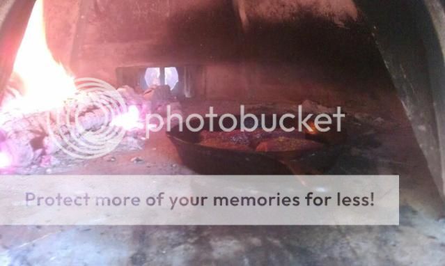

    My wife doesn't eat pizza, so I threw a few venison steaks in a cast iron pan for her:
    [​IMG]

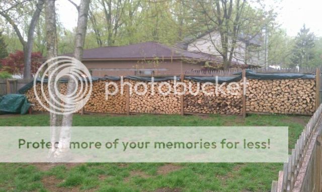

    These are my wood racks from spring. I have doubled this in wood now. I hope I save enough to heat my house this year, and not use it all in the oven!
    [​IMG]

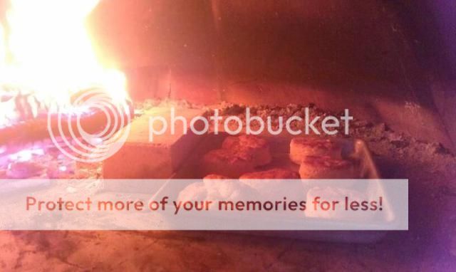

    Forgot the biscuit pics!
    [​IMG]

    Great pics Capt! You will have a lot of good times from that oven. I like the herringbone brickwork for the oven floor.
    I've thought of putting some type of angle iron to prevent the coals closest to the pizza from burning the edges. Is that what the brick is for on the biscuit pic? The biscuits and gravy looks really good. I have to do biscuits and cornbread soon.

    I used the firebrick to deflect the direct heat and flame from burning the close edges. Works great!
