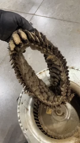

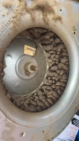

New to the pellet lifestyle, so bear with me. Former city guy in rural PA now.
I moved into my house over the summer and it has both a small propane fireplace as well as a Quadrafire CB1200. The propane fireplace is mostly for show and is sized accordingly and could not provide primary heat for my house.
The house is a 2000 sq ft one, with three levels. The ground floor is all utility and storage and I'm not concerned about heating it. The CB1200 is on the first floor.
The short version is th
at it's not heating as much as I think it should be. When it's 30 outside, it runs pretty much constantly to get the house up to 66, which is all it can manage. It's a newer house (2008) and is pretty tight. Truth be told, the 15000 BTU propane fireplace is doing a much better job at heating the house.
I've been running it for a good month now, so this is based on more than a few days.
I gave the stove a good cleaning. I think I've got pretty good airflow to the combustion side of things. Nice snappy flames, about 6" high. I've got a good feed rate on the pellets. Electrically things look OK. When the stove calls for heat, it does its thing and has no problem building a flame.
I installed an OAK, but that didn't make much of a difference.
I'm really thinking the convection motor may need to be replaced. I can stand about 3" in front of the stove comfortably. 6"-12" is warm. More than a foot or two away and not much happening.
When the convection fan kicks on, it's definitely LOUD, to the point that it's tough to listen to TV in the room, and it's audible through most of the house. No grinding or squeaks, just a loud fan. And not much coming out of it.
I did take the temp, and right at the vent I'm getting 300+ degrees on the metal (thats where my temp gun taps out).
So I feel like the stove is burning properly, I know it's getting plenty of fresh air, but it's just not generating the heat output, or at least it's not distributing the heat.
Thoughts?
(And I know, the stove is filthy in the video, I swear I cleaned it later)
