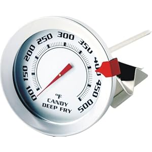

    Where is your thermometer placed? I also have this stove and the only place I can think to put it is just above and to the left of the door (on the face, not the top of stove). You don't want it on top like most stoves because there is an air gap for hot air to blow through from the fan. I'm not sure how accurate of a temp I'm getting from this location, but I've found that with dry wood (confirmed with mm), air fully closed, and secondaries going absolutely crazy it will only get up to 500-525. I think I've got it above 550 maybe once or twice. And like you, I've also found that leaving the air open will not get any higher temps... the temps only start climbing into the good burn zone after I start closing down the air. I'm thinking that the temps are being somewhat under reported since the thermometer is right at the outside edge of the firebox.
    I wonder if the front of the glass would be a better location for the thermometer?

    I have my thermometer placed in a similar spot - only on the right hand upper corner just next to the air inlet control lever. I mounted it to the door surround once and temps seemed even lower.
    The owners manual for the stove suggests to not burn over 840F so I am thinking I am not even close to the heating capacity of this stove which is what is making me question all of this. Not that I want to try to burn at 800F all the time but surely, 600F should be attainable which is ~20% higher than what I can get so far - thats a big difference in heat!

    I read in a thread here recently that (as best as I can remember) a thermometer on the front of a stove registers something like 125-150 degrees less than one on the stove top. Obviously with inserts that's the only place you can put one. I have a similar size insert with a thermometer on the upper left side of the front by the door. It rarely gets over 550, even with a fully engulfed load and the secondaries rolling. The insert is cranking out a lot of heat at that temperature and can drive us out of the living room if I'm not careful. I'm agreeing with the idea that your wood is not ideal. My first year burning I had less than ideal wood and mixed it with BioBricks to get the desired heat. I like the result so much that I do it routinely now--about a 50/50 mix.

    I have the CW2500 and locate a magnetic thermometer in the same location, top left of the door. It reads darn hot if i get a load of hedge rolling (highest BTU wood there is). This is from memory, from last year, my first year burning, but I'm pretty sure it was reading 750deg+. We got worried a few times cause it was reading so hot. The tubes were glowing too.
