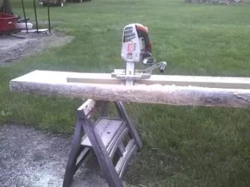

    You can learn something new everyday with this book! I was looking at the re-saw pages and thats when the real deal on the mini mill hit me. (this pic is very close to what you see in the book) Hes saw I believe is the 020.
    AWESOME BOOK BTW!

    I would make nice size cants until you have the project in mind. Then its just a re-saw to size. 4, 6, 8, maybe even 10 and 12 inchs thick You would be ready for just about anything. 8-10 foot long.
