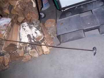

check out my new tool
shoeboxlen
Ok get your minds out of the gutter ya pervs

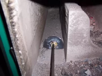

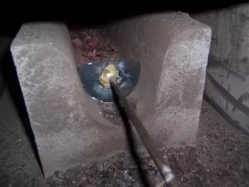

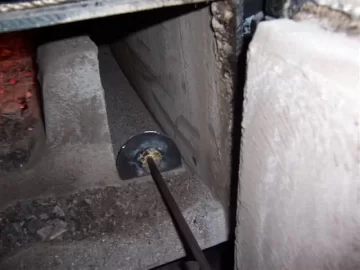

I got the idea off of a you tube video that was posted up earlier this week so I went to the auto shop class of the school I work for and had them weld a steel rod to a u shaped piece of steel brought it home and ground it down until it was the right fit and walla a perfect boiler ash rake!

Great - first boiler envy and now I have to move to tool envy!! Seriously, nice job - looks really handy.
thanks seriously making the tool was so easy the hardest part of the whole deal was the time it took to grind it to the proper shape if you can find someone with a welder its a 2 minute weld. I dont know if you could do the same thing with jb weld because of the heat. but hey who knows.
shoeboxlen said:
How about just a hardware store bought threaded rod and bolt it together?
Mike
steam man said:
shoeboxlen said:
Mike
that would work too! good call..
