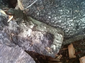

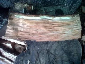

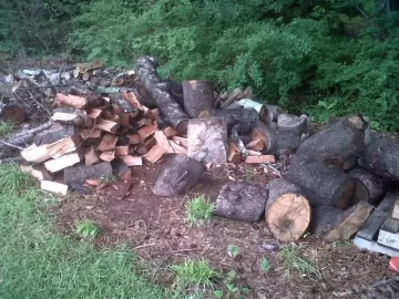

Well for fear that a pirate ship will appear along our canal, Here are your photos.

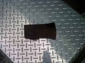

The pile is a good sized one. 2 solid truck loads. I split every thing I could last night before the rain came down. The rest need to be cut a little bit (gonna end up with LOTS of uglies on this one). I cant get over the smell when splitting, and its even stronger this morning after rain last night. I took one round which was pretty much rotten, took it just to get it off his yard. I split it open and found what was in that last photo...
*side question: There are flies all over these logs, not on the oak. Weird.

I think Im going to put a new handle on the axe head and take it back to the guy who gave me the wood. This should help keep the wood karma on my side, right?
Besides I dont see where I need another axe.
He was a nice guy, and $10 for 2 truck loads of wood isnt a bad price :)
Flies just love the sweet sap that comes out of cherry. You have to remember, even though it's a wild cherry, it's still a cherry tree.

Great idea. Clean up the surface rust,install a new handle & touch up the edge with a good file.He should be very pleased.
