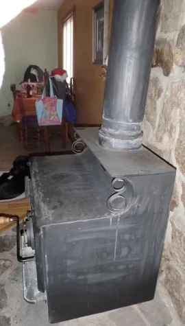

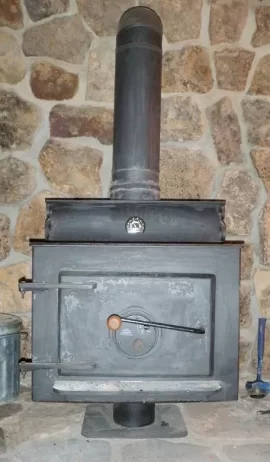

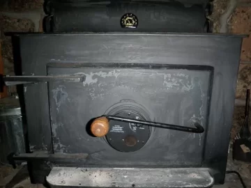

    Here are a couple of pictures. Hopefully someone can tell me something :) thanks a bunch!

    Well, the first thing that sticks out at me is how close that stove is to the wall. Seriously, get a pro out there to check this out before you burn even one more fire.

    shari there is stone face wall ,please look at the heavy door this could tell us that this is a coal burner , which is heavy.

    "stone face wall" means nothing. If that is just a stone veneer, which is how it looks, and actually what you imply, then if it is framed with standard construction that is no way safe/code.
    I have seen many stoves that burned coal and/or wood, living, well, in coal country, and the doors generally are not much of an indicator.

    Looks like you have a older model stove which you should not be overly concerned with providing you treat it right. Looks like you or someone else washed it down with something as it looks a little smeared. What temps are you burning at? Are you heating your home well with it? Sorry for all the questions but can you tell if that is single wall pipe or double wall? I have a double wall and it often clicks and cracks randomly when coming up to temp or cooling down.
