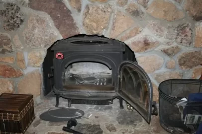

    Nights have been chilly and I've been getting the urge to see the Oslo in action. Having run it for two seasons already I decided to clean the flue.
    Before going up on the roof I attached a shop vac to our OAK inlet on the outside of our house and turned it on. I also opened the air control on the stove all the way.
    I then went up on the roof, removed the cap, and found a healthy flow of air going down the 6" solid stainless liner. I brushed out the flue without inhaling a bit of creosote as I have when cleaning flues before.
    I replaced the chimney cap then went down to the Oslo, removed the oval top plate, and vacuumed out the creosote that had accumulated at the stove outlet. I set the oval plate back in place (no fasteners needed) and went outside and shut down the shop vac.
    My wife who had been sitting near the stove the whole time doing some paperwork never saw anything exit the stove during the whole cleaning process.
    We're enjoying the season's first fire now.
    I just added one more thing that I like about OAKs to an already long list.

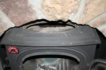

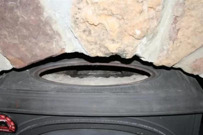

    Hmm, good question. The OAK inlet on the back of the Oslo does feed both the doghouse inlet at the front of the firebox and the secondary burn tubes so I guess its possible. However, the secondary tubes are located at the top of the firebox below a smoke shelf so its hard to imagine that the heavy creosote would stay airborne in the stove long enough to rise and enter the tubes. It was apparent once I pulled the top oval plate that most of what had fallen down the flue ended up near the stove outlet.
    I did not collect much if anything in the shop vac connected to the OAK inlet outside. But the negative pressure it created in the stove and flue was enough to keep ash and creosote under complete control during the cleaning, something I've never been able to achieve before.
    I can tell you that the secondaries seemed to work very well last night. In fact, they seemed more active than I remember from previous seasons. The vacuuming may have cleaned them out some.
    I've included before and after photos. You can see the creosote that was brushed/sucked down in the 2nd photo both in at the stove outlet and within the stove. The 3rd photo shows the cleaned outlet area. The white fluffy stuff is the insulation blanket that sits on top of the burn shelf.
