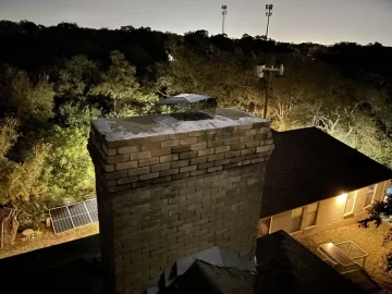

Picture of the chimney for fun:

The 1800i is not setup for an outside air supply. There wouldn't be a place to connect to the stove. Also, there is a risk of draft reversal with the intake air higher than the stove intake.

Oops, must have read the wrong manual.
I have heard about draft reversal being a thing even with inlet down at ground level. I guess it would be even worse with my hair brained idea?
