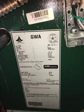

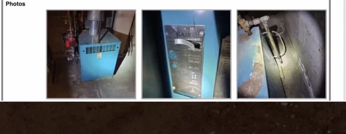

Thanks for the info! I have to say I’m certainly learning a lot. We have no plans in replacing the roof at this point…we will be replacing some masonry at the top of the chimney. Hopefully the clay tiles are in good enough shape because we are bleeding money and there seems to be the possibility that the current width of that side of the chimney may not be large enough for the correct size metal flue liner we would need. I’m not sure about the pilot flame the previous or current boiler but it was 30 years old…here are both.
