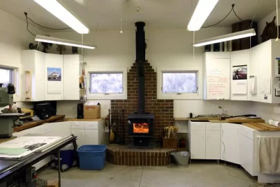

I heat a workshop smaller than that with an inexpensive steel plate, EPA-approved non-cat stove, which will take 17" splits loaded E-W, and it does not "drive me out of the shop". (I also find it attractive, but that's about as subjective an assessment as can be made of anything). It does its job and does it quite well, especially in combination with a centered ceiling fan running on medium speed updraft. You really can control how much heat a woodstove puts out, it ain't gonna pump out its max capacity all the time unless that's what you want it to do. Rick
  • [Hearth.com] considering a small woodstove, looking for advice
