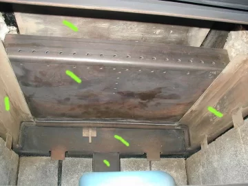

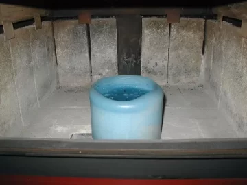

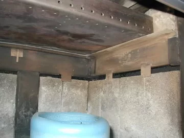

What the hey , i think this calls for PICTURES ! Alright , the stoves is a Pacific Energy "Summit" shown in the pictures you will see one pic with green marks....... what the green marks show is the parts in the stove that is stainless steel . You can also see the "blanket" / "padding" that we are talking about , its stuffed on each side of the secondary burn chamber . Once the burn chamber is set the padding is locked in to its area . ......... O' and before somebody asks the pin in the back is the key that you take out that locks the secondary burn chamber into its spot. I guess if you say stuff a large log into the stove and it hits the sec. burn chamber its not going to move .

Nice Candle!!!
Where's the Blanket Pic's????
Your Refractory Brick looks like the pretty "Normal" wear.

Thanks for the photos, that system looks real beefy, much more so then some i have seen.
