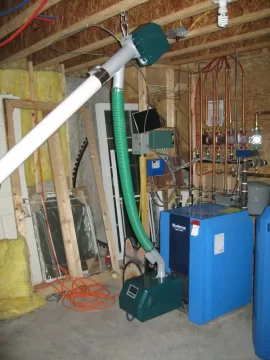

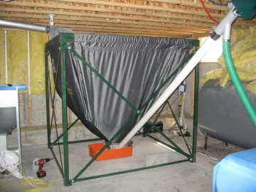

    As promised here are the pics. I've got this set up so I can switch back to oil if needed in less than 10 minutes.

  9. BoilerMan
    BoilerMan
    Apr 16, 2012
    1,717
    325
    Northern Maine
    Is the pellet bag completly sealed? When they fill it do the have an pnumatic truch with a hos to pull the air back out which they use to move the pellets, keeping the dust to a minimum? This seems like the best of all things pellet. I like it!

  10. AndrewChurchill
    AndrewChurchill
    Mar 31, 2008
    668
    62
    Vermont
    The bag is sealed and when the pellets are blown in the bag inflates and acts like a large filter so a return line is not necessary.

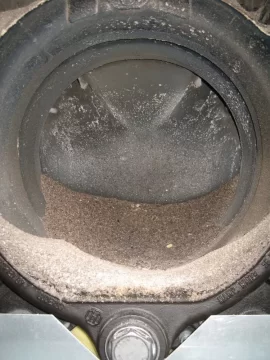

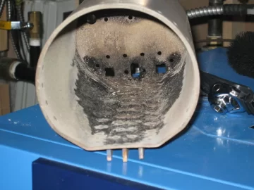

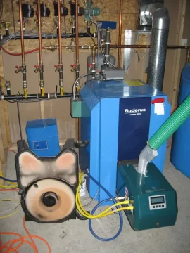

    I did my first cleaning yesterday. Based on the amount of ash in the boiler it looks like I can go about 6 weeks before I need to clean the boiler during the summer. I got the compressed air option with this boiler and it's keeping the burn pot very clean.

  20. TheMightyMoe

  21. AndrewChurchill
    AndrewChurchill
    Mar 31, 2008
    668
    62
    Vermont
    Look at the right picture in post #18. That's the inside of the boiler.
  22. TheMightyMoe
    TheMightyMoe
    Aug 2, 2012
    596
    140
    Fairbanks, Alaska.
    That's what I thought, seems like you would lose ALOT of effiency. That much ash would block tubes on a LE. But I suppose pellets are much cheaper then oil.
  23. AndrewChurchill
    AndrewChurchill
    Mar 31, 2008
    668
    62
    Vermont
    I'm getting 82% efficiency with pellets vs. 87% with oil. I've done a couple of cleanings and so far there has been no ash accumulation in the heat exchangers. As long as I do regular cleanings there shouldn't be a huge loss of efficiency.
  24. TheMightyMoe
    TheMightyMoe
    Aug 2, 2012
    596
    140
    Fairbanks, Alaska.
    I'm ignorant when it comes to Buderus stuff, how are you getting the efficiency number? Just very curious, because that seems like a lot of heating surface that is getting covered up, and every inch of heating surface covered is fuel wasted. Its good none of your tubes get ash in them. With the swing out door, should be pretty easy to keep up with the ash, and definitely is still cheaper then oil.
  25. AndrewChurchill
    AndrewChurchill
    Mar 31, 2008
    668
    62
    Vermont
    The Buderus is a triple pass boiler. Only the bottom of the boiler gets covered with ash so only a little of the total heating mass is actually effected. The efficiency number comes from a probe that analyzes the exhaust gasses in the flue.
