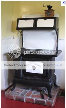

    I'm looking to maybe purchasing something like this:
    [​IMG]
    I did look at one locally but the son-in-law for some reason gutted out the oven. Both heat elements were gone, racks were gone, etc. I would have made him an offer on it but I guess I hesitated because even though I know I can get original replacement parts that doesn't tell me if the other wiring (to the controls) are good or not. Plus, finances are limited and I didn't want to get involved in completely replacing interior wiring.
    On the stove in the picture the 'pattern' is from an 1875 model cast iron wood fired cook stove but has been modernized with electric burners and oven. I guess I'm just wondering if anyone has any experience with this type of 'modernization' of the old cast iron stoves.

    OK, I was under the impression you were going to be cooking with wood or coal. The electric elements would be the same as they work on a electric range. Sloooow and expensive ;-P
    I can only give you the pros and cons on most wood cook stoves made today.
    Once you get used to moving the food around to control the heat, you won't want anything else. They're great to bank off for the night and depending on how much heat is needed, they keep the entire house warm through the night. The larger the firebox the better for wood. All the older antiques lacked any sizable firebox since they were mainly built for coal with a shaker grate.
