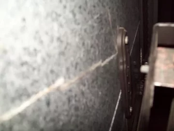

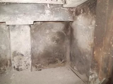

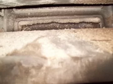

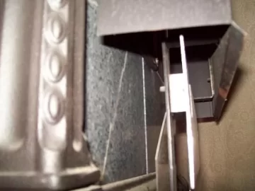

I think I have bigger problems then the crack in the stone. I emptied the stove this week end and inspected it. I took pictures and want to get your opinions. I know I have a problem but is it safe to burn till I can get something done about it? I took some pictures looking up toward the flue in front of the baffle and secondary burn tubes. I don't know what the part is called but it is cracked. I have also posted pics of the cracked stone from the inside and out.

Sounds like you are likely running it at the very high end of where you should be, if you stay at 550. But if that's just an occasional peak, and you trust your thermometer, then this may be considered excessive cracking. Tough to think Hearthstone isn't going to look at this and not claim you overfired it, unfortunately. But I'm no authority...
I will say, if this was my Heritage, I would still burn it. Probably put some cement on the cracks, especially now that it's all cleaned out and cooled... It's not going to puff smoke out - you would draw combustion air in thru the cracks during normal operation - that's the real risk, is those cracks opening up and allowing unmetered fresh air into the fire.
Your first picture - is that the inside of the top front left corner of the iron support frame? Can't say I'm shocked to see that crack. they could double the size of that radius and it'd still crack there. I doubt the stove is in any danger of falling apart, but you want to keep an eye on it and get Hearthstone to check into it.
Ewh! Looks like the support casting for the stove top is cracked out. Almost looks like it is cracked on both sides from the radii. The cast part has failed. It is of course replaceable while they are replacing that rear stone.
The rear stone looks to have also cracked from the through bolt that holds the little cast iron piece on there. Another stress riser. Since it cracked on that bolt hole it is not natural and very likely goes all the way through. I think that the rear block needs to be replaced.
Get Jim from HS on the line and get his decision. He will set you up with a local dealer or make a deal. Not sure if they will claim overfire but too late now, you need this fixed. The refered dealer can also give you a price to fix it. These stoves are supposed to be fairly easy to take apart not that I'd want to.
I wouldn't burn it unattended until you filled the crack with cement. I wouldn't fill it until you get in contact with Jim.
