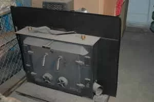

Pictures and measurements would be great! I don't even know what the blower box looks like. I have included pics of my exact model and the blower I think fits. thanks.

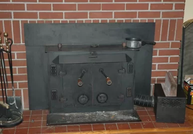

I will see if I can get you some more pics and dims tomorrow but here is one shot I had on my computer of my old one.
Looks like the blower box on the top of the insert on the one pic you posted, and yes it uses a squirrel cage fan with a variable speed control.

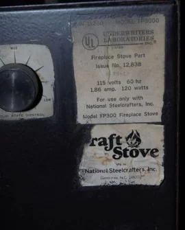

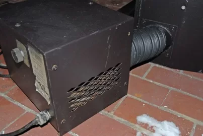

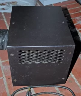

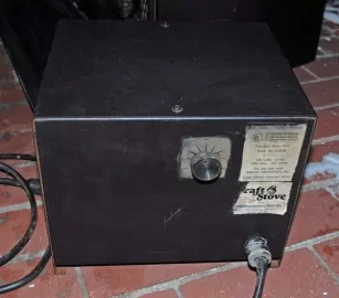

A little late but here is some more pics of the blower box for you. Finally got around to getting it out of the shed to take some pics. It is just a regular squirrel cage fan in a metal box, just use some 4" flex metal exhaust pipe to attach to the stove.
