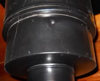

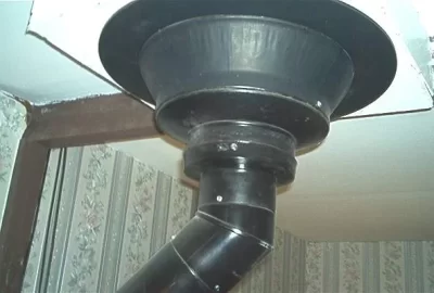

It all depends on what brand your stove pipe is. i got lucky and found adapters to go from 8" Metalbestos pipe to 4" Simpson:
can you take a close up pic of the part where the adapter is? thanks phil

Not sure what part you mean.....want me to just take a pic of where the 4" meets the 8"?
So the bottom smaller part is the adapter? And the the larger part by the ceiling is what was left after you removed the wood chimney? Also what's supposed to support the chimney? I didn't see any thing in the attic? If I remove the black part in the house will the rest of the chimney be supported? I assume so cause the one section by the ceiling looks to be adjustable. Sorry for the sillly questions I kinda just jumped into this with out much research. Phil.
The box in the ceiling that the stove pipe goes through, should be a support box. If the current installation is up to code and used the proper parts. That way the stove does not hold the weight of the chimney.
im pretty sure its up to code i have the c.o for it. i did find a sticker under the cap on the roof that said metalbestos is that a brand or a style of pipe? phil
Yep. Selkirk Metalbestos is a brand. Glnow go forth and see what adapters they have. They should make one like Simpson does. They "should" ??

looks like i have the same metalbestos pipe u had. where did you get your new pipe from? thanks phil
if you cant find a direct fit look into a universal adapter to fit the large pipe, I converted about 4 years ago & only ICS made a 4" pellet to 7" class A adapter.
the universal I have just fits over the tail piece of the ceiling thimble using high heat silicone and 4 sheet metal screws
you would have to check the brand of pellet pipe you plan to use to see if they offer a universal adapter, ICS is good pipe with a life time warranty but its the most expensive.
