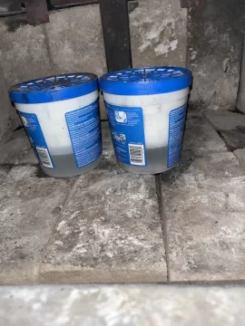

I started this year. I checked it tonight. There was water in the bottom. Be careful, i suppose if u forgot to check it, it could overflow. The water is a salty brine from the obsorbant that is used. I imagine that would be terrible for the metal bottom of your stove/and bricks, if it ever overflowed. I’m looking to switch to the moisture pouches instead for this reason

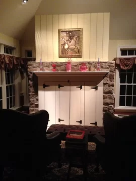

I just close the fireplace doors and place a GoldenRod or DriRod (made for gun safes) under each stove. The small amount of heat coming off the DriRod keeps everything dry.
The avatar shows it open, here's the same fireplace in summer:

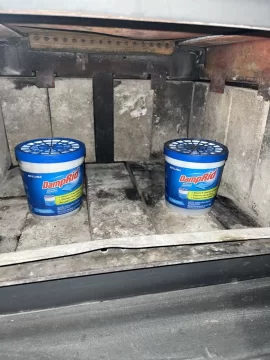

Yes I do use damprid. In fact, I take the telescoping section of stove pipe out and cap the stove and the chimney sides. That creates a closed box stove (I block the air inlet too) in which I put damprid. My stove is in a basement that needs dehumidification in summer.
Humid here near the Sound. The moisture coming down from the chimney would likely force you to empty the damprid every few weeks. I have 2" of water total from the whole season because it's closed off.
