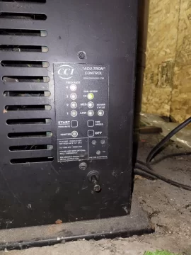

I recently bought a house, and I have a danson cc3 wood pellet heater that is already installed in the garage. Heater has been used off and on since it was installed in 2003, but is in fairly decent shape and works quite well if left at feed rate 4
From what I can tell everything mechanically is in good working condition, but the feed auger only functions at feed rate number 4 or during cold startup. If I have the feed rate set to 1, 2, or 3 after its completed the warm-up cycle, the auger doesn't actually turn and the fire slowly dies out.
I haven't been able to find a lot online that's related to my problem, but from what I can tell it seems like a control board issue since everything works just fine when on feed rate 4.

If anyone has any idea or leads on where I can get new or used Accutron and thermostat control boards and a user manual for the stove/installation manual for the thermostat add-on I would greatly appreciate it.
