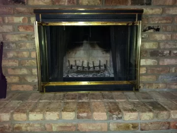

Hello men! And ladies too! I've been lurking for some time and decided I would get some of your feedback.
I'm in the market for a wood burning insert to replace the Heatilator wood insert the came with our home.
We live in Iowa which can produce some very cool winters. I'm a stayathome dad with some extra time on my hands. We live on 4 acres with an abundance of Burr Oak, Honey Locust, Shagbark Hickory, ect.
I've burnt wood most my life. My question is this... With so many dealers, manufactures, ect, how did you decide on your stove? We have electric baseboard heat which is giving me all this spare time with not cutting, splitting, stacking, ect. I got our first electric bill that scared the bejesus out of me. Time for an insert! I have spent the last 10 days doing research and thought I had it narrowed down to Osburn 2000 until I called and guy says it wont fit. I got a bid from a local dealer for $4600 for a PE Super that about gave me a mild heart attack. Now I feel like I'm behind the 8 ball with all winter just around the corner. So...what would you knowledgeable fellows do? I'm open for suggestions!

Im thinking an insert is my only option. I can't make out the model number of existing insert. My dimensions are
34" wide
27" high
24" deep
I plan on doing this myself with a stainless liner. Thanks guys for all the quick responses!

That's what I thought! So I called osburn and the rep said that at 17" back, I don't have the width. I'm on the fence with tearing out the brick ledge but my wife doesn't think that's a good idea

Got it. So your fireplace tapers.
Did you check out the Enviro? It seems to do well in these types of installs.
Well if you're going to take that rout than you can basically put whatever you want there. If you're looking for a more simple solution there are some units that some work in that fireplace.
