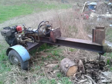

    I'm on the look out for a used log splitter, and found the following one for sale locally:
    Anyone have any suggestions on evaluating an older home made splitter? Is there any way to figure out a rough estimate of how many tons splitting pressure this unit could produce based on the stats given?
    I've heard the 9 hp Yanmar diesel is an excellent engine.

    Doesn't look like a bad deal. Something like that for sale around here would easily be $1k more than what they are asking.

    Can't see much in pic about the fab work but I think a diesel splitter is a fantastic idea. Technically my splitter is diesel powered and it sips fuel.

    Find the area of a circle 2.5 inches in diameter (3.14x 1.25x1.25) or Pi R2 IIRC. Multiply by the psi of the pump, which you should be able to determine at the Northern website, or you could assume 1500 but I would look it up, it could be higher. Then divide by 2000 to know tons.
    At 2.5 inches, it is not superpowerful, but otherwise looks like a great deal and should be very fast with that small piston.
    If you need more power you could always upsize the piston to say 4". The engine alone is worth the price.

    I'd drop every thing i was doing & go get it ! The rod coming out the cylinder looks to be 2.5 ". The one i'm building just the cylinder is $645.00 , so i wouldnt hesitate for 700.

    This is a very good point, the cylinder looks much larger than 2.5 inches.

    Evaluate the condition of the hoses. Splitter looks like it's been outside most of it's life. I see a pressure gauge. It will indicate the max psi of the hydraulic system if you extend/retract the cylinder fully and hold the valve open briefly. If that's a 4 inch piston in that cylinder then assuming the pump throws out 2800psi (a typical setting) 2800psi X 12.56 in sq. = 35168 lbs of force / 2000 = 17.584 tons. Assuming a 24" stroke that would give it a cycle time of about 12 seconds. (301.44 volume out + 183.69 volume back = 485.13 total volume for cycle * .0043 gallons in 1 cu in= 2.086 gallons required per cycle 60 seconds / (11GPM pump / 2.086 gallons required) = 11.4 sec cycle time)
    You can buy a new horz/vert splitter with similar performance for about $900-$1000 but it wouldn't be diesel. Engine is very over powered for the application. Would be fast with a 16GPM pump should drop it to about 8 sec. Personally I'd offer $400-$500 depending on condition. What's with the receiver on top of the wedge?

    He said he used to use it with a tire business for crushing wheels for recycling, so I'm assuming he had some sort of device that slid into the receiver for that.

    I'm going to look at it this week. If it is seven tons, I'll probably pass, if its 17, I'll probably buy it.
    As bioman noted, the rod coming out the cylinder looks to be 2.5" (owner stated, "cylinder is 2.5" bore x 30" stroke").

    I'd be buying that dog RIGHT FRIGGIN NOW......That cylinder is WAY BIGGER than 2.5". I think he meant the ram was 2.5". Thats more like a 5" cylinder, which would put it in the 20 to 24 ton range if I am correct. You can always upgrade or repair parts on that thing, if it is a diesel and it runs good, you can make your own fuel and make it cheap! Only if you are mechanically inclined though, there looks to be some tinkering in that old girl....

    I was wondering about the cylinder size versus bore size. It looked like a 4.5" to 5" cylinder in the photos, but I wasn't sure how these things are actually measured.

    No way that thing crushes wheels @ 7 tons. >> Gotta be more.

    Yeah I was thinking that too. It looks like it might be a lot more than 7 tons, as Scotty pointed out above.

    For the record - I don't run either of my splitters anywhere near full throttle. Even if the diesel doesn't hit 3600 rpm it wouldn't be a deal break. Second, I agree with those that think the cylinder in bigger than 2.5" (at least from the pics). 3rd, you are going to use so little fuel for home use that I wouldn't even bother with anything but good old diesel in that thing. 4th - I would be going onto fleebay and buying a 16gpm speeco pump (I bought one new in box for $107) and watch the performance of that thing increase by 30% (you are currently over horse powered - that motor will handle a 16gpm pump easily).
