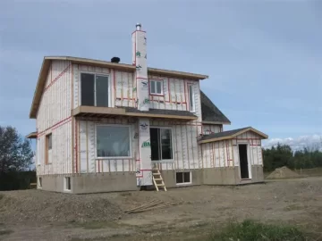

For now, I have 1 wood stove and solar passive.
As you can see on the pict. the house is not finished yet. But all the back of the house is facing south. You can see the small roof between 1st and 2nd floor. It's 4 feet wide. So in the winter time, as the sun is low, it will hit the window and dump a lot of heat on my first floor. In the summer time, as the sun is high, this will block the sun from getting in the house and overheating my main floor.

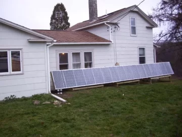

I just built a solar air collector this year to supplement my wood heat (picture attached). I made it in 3 removable sections so I can remove it for the summer months. It's based on a downspout design I found at the Simply Solar yahoo mail group:
(broken link removed)
I heat mainly with wood and usually only use around 80 gal. of fuel oil a year. I mainly burn the oil furnace in the spring and fall when it's a little warm to burn the wood stove. I also tend to use it on the evenings we get home from work and the house is cold. It's either try to play catch up with the wood stove and basically burn an extra fire's worth of wood or warm the house up with the furnace. So far the solar collector has been great. Today, even though it was cloudy most of the day, we got some sun in the afternoon. The house was a comfortable 68 degrees when we got home even tho the wind was blowing and cold all day and there were only coals in the wood stove. On a good sunny day, it heats the house (so far at least) without even burning the wood stove. We have very few good sunny days in central NY, but solar makes sense even here. Solar is a great complimentary setup to use with wood heat. I have no doubt that it will bring my oil use down close to 0 and maybe even put a dent in my wood use.
