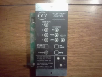

Hello.
I have fried the Acutron control board on my CCI/Dansons CCGB1. It is a base level Acutron - not Acutron 2 or 3, just Acutron. I don't have a thermostat or an ignitor. I can't find the base level Acutron on the internet, only the Acutron 2 and 3. My question is whether either of those will work as a replacement for my control board. Are the wire harnesses compatible, or is there an adapter? Will the new control board operate without the thermostat and ingitor?

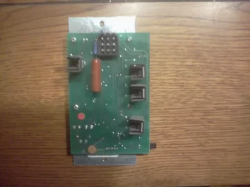

Could someone post a picture of the back of their acutron 2 or 3 board so I can see the wire harness receptacle? Or maybe just describe it to me. If the wire harness is 9 pin, square with 3 ribs on one side I'll go ahead and buy one and hope for the best. $275 for a control board is better than $3000 for a new stove.
Thanks!
Just to confirm: Acutron IV does indeed replace the original Acutron control board. The wire harness fit, the boltholes aligned, and everything is operational.
