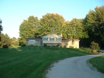

    Here's a pic taken almost from the street - you get the idea of the amorphous border I have going on .....
    There's probably another 200' of drive behind the house.

    Lovely property, by the way--How about using a mattock (pickaxe) to dig a nice even trench along the sides and set those concrete wall blocks you get from lowes and home depot? Looks like you need a lot, but if you just pour concrete, it will crumble and grass will take over anyway. Learned that by experience. I saved my $$$ and had mine blacktopped, but it is not as long as yours.

    You are below the sod. You need to be above the sod.

    firebroad - thanks for the compliment. We are very blessed to have our property! I might price out some of those blocks - wouldn't they want to move all over seasonally though?
