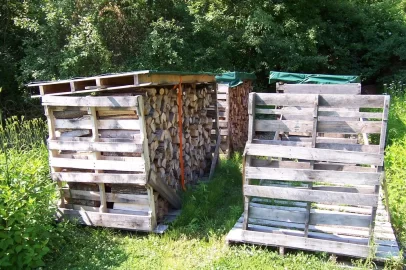

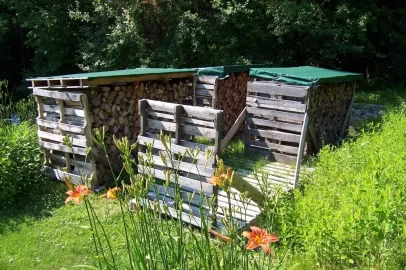

    You've, no doubt heard of the farmer who stacked all the hay he could outside and put the rest in the barn!!! Well I had a similar situation with my wood. My woodsheds became stuffed with the bonanza of free wood I was given last year so I needed to stack some outside. There's a local manufacturer that receives it's raw materials on pallets that are slightly longer than 8 feet and about 4.5 feet wide. I picked up several of them. One for the base and one for the roof. I stapled a poly tarp to the roof pallet and put a slight pitch for rain and snow run off. Working well for over a year now.

  22. Tennman

    And when I see these pics from Fred, I lust after a tractor with a front lift. ;) Good plan Fred.

    I don't have anything that will lift those pallets nor do I now have anything that will lift a standard pallet. The big tractor went down the road and I now have a wimpy little Kubota with a 1200 pound lifting capacity and no forks. Good for digging in the flower beds. Downsizing!!! Those pieces of wood will be handled twice. They will be moved to one of the woodsheds when space opens up. They aren't in a good spot for access in the winter and I don't stack any wood indoors. A little more work but I can't walk away from free wood and besides, over the years I have become an expert wheelbarrow driver so "nothing to it".
