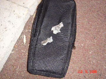

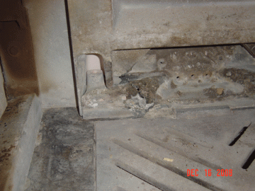

Anyway was a little warm out yesturday so I let the fire go out last night and would start again this morning. While cleaning out the fire box I noticed a crack it what looks to be (per the owners manual diagram) the shoe refractory. Also upon exploring a little more noticed some pcs of brittle ceramic laying in the back in front of the shoe fractory. I have tried to attach some pics.
I don't know if I bought it like this or something I did (running to hot at start ups or to long without dampering down). Question is am I down till I can replace it or can I still burn.

looks like pieces of the refractory in the ceramic thing...
i would keep burning till the season is over.. keep an eye on things so you don't overfire it, then replace it in the spring
