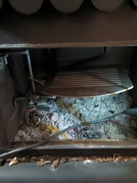

I am about to start a fire in an old Earth stove that I have installed in a new home. I bought this unit used and am wondering about whether or not there should be some sort of plate/shield below the entrance of the flu pipe. Or, is it designed to have a direct entrance from the flame? Please see picture.

Sure looks like it needs a baffle. Without it, the efficiency will be very low and it will be a wood pig. Here's an old thread on the topic.

Thanks much - perfect!

Now, this is interesting. I do have 2 pieces of fiberboard that I thought came out of that stove when we picked it up. I was thinking that I had removed it before transport, but when I started the install, I could not for the life of me figure out how they installed since there is only a lip on the rear of the stove and nothing on the front. So, I assumed it went to something else.
So, it they do go to this stove, I have no idea how they would install.
It would be great to see pics if anyone has some. I have tried finding one on Google, but no luck. I am pretty sure mine is a model 100, but may be a 105?

Originally that model did not have a baffle. It did have a pipe that came from the back wall of the stove ran about 4' up the stove pipe. This was an attempt to introduce secondary air in hopes it would burn the gasses in the flue. Most people removed it and plugged the whole with a pipe plug.
Newer models of Earthstove had a baffle with secondary air tube's pretty much like epa stoves of today. They also had catalytic stoves and even a hybrid. These newer stoves look much different. They don't have any of the ornamental scroll work or the scallops.
