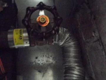

Why do you run the room blower at such a slow speed? I would run the blower at least 5 or higher just to get the heat to dissipate. Its good to see that you use the lower buttons lbf I run my pdv from 1 to 6 one level 1 heat level for low heat. I do have a gate valve to adjust the air intake on the OAK very helpful at low burns.

I installed a gate valve for low burn I close it down to reduce the amount of air entering the burn pot it allows the heat to stay in the stove instead of just up the exhaust pipe. Also when the stove is on high these pdv25s huff or reverberate from getting to much air so I can reduce air with valve. Many other stove have air control so I thought it was a good idea. I call Englander about the huffing noise and they said to put a piece of tape over part of the air intake to reduce air I did and then I latter did the valve. It work for me I got the valve on eBay for cheep got a 1/2" stub pipe and a rubber coupler that's it.
