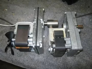

Man I love success. Gleason Avery was very easy to deal with they even called me after I placed my web order to confirm what Stove the gear motor I ordered was for! Then built and shipped it the next day. The quality of the new motor is easily decernable instantly. Here is a picture of the two to compare. Man I sure am glad I stumbled onto this forum and found the information! Save $50 and received a better product! How can you beat that.

But....wow, what a difference in those motors.....have you installed it? Opinions??
Yup it has been up and running for a couple days. Works perfect and quiet to boot.
