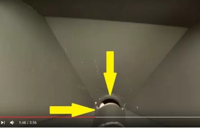

Take a look in the hopper at the auger tube and see how much of a lip is sticking up above the walls and in the flow stream of the pellets (see picture). This lip and the rough surface of the hopper are the biggest issues with pellet flow. I would suggest you run the metal tape over this edge to try and improve things. Also, use a quality HVAC foil tape.
