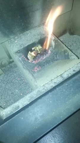

I have the old style pot... but this pic was taken just over 20 hours of burning on setting 5. I have other pellets that i cant ignore for more than a few hours or else the pot over fills.
And i should add that im currently in mode D as well for that photo.

Wow that's a clean pot. Mine has never had that little of ash. Mine actually gets full on a lower setting. I wonder what the heck I'm doing wrong???

Like i said... pellets are not all the same.. i bet i have tried 15-20 diff brands and have found 3 that burn good in my stove.. the rest either fill the pot with half burnt pellets.. fill the pot with ash. Or dont produce enough heat to even talk about..
