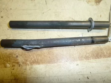

    13 months later I am replacing the igniter again. This time I bought Grangier item # 2E911. The 2E911 is one inch shorter (4") but the Englander igniter tube housing has enough room to accommodate. Below are the photos of both failed igniters. Top picture is Englander OEM. Bottom picture is TEMPCO brand from Grainger which had structural failure in addition to electrical failure.

    other than seeing a split in the side of the igniter the best way to see if it is good is to do a resistance check with a meter.
