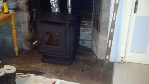

    Got it in (a while ago, actually) and just wanted to send out a big THANK YOU!! for all your help. It's running wonderfully, was an easy install and my kitchen is so much warmer.The inspector said it was a great install and had no concerns. Just need to spray those pipes a nice flat black and it will be perfect. Thanks again!!!
    Of course, the family expects me to cook now. _g

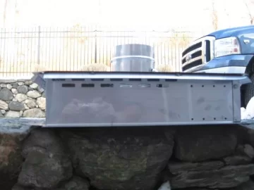

    Here's the harman cap I'm installing ..pulls combustion air in from the sides
