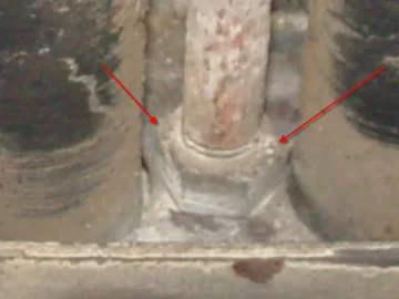

    Hello
    Enviro EF2 Heat Exchanger Tubes Cleaning Rod Sticks.
    Yellow arrow shows that the rod does not pull or push the rake evenly. It seems to really stick when one side goes too far!!
    Any suggestions?
    See pics.

    The Enviro cleaning rod EF-051 (See pic below) goes right thru the rake with a nut on each side.
    Also each end of the rake drags on a lip on each side of the stove.
    The Avalon Astoria Cleaning Rod screws into a nut that is attached to the rake. This gives no side to side flexing when pulling and pushing the cleaning rod!
    The last picture below shows the Travis Ind. cleaning Rod screwed into the Nut on the Rake. Much more rigid!!
    So any ideas how to re-engineer the Enviro Rake or where the cleaning rod attaches to the Rake??

    Well Hokey Pokey, This rod has no nuts at all!! It screws right into the rake!! That is the Problem!!!
    I just removed it, see pic below!
    I can check the hardware store tomorrow and see about some washers and nuts!
    Please check your friends too, I am very interested now, we may have a good solution in the works!!!

    Found the Fix for 0.14 Cents for a Stainless Steel nut!!!
    The cleaning rod threads at the end are M7 metric or 1/4-20 US !!!
    So I put the rod into the stove and threaded on the nut then screwed it into the rake!! Just like the Astoria!
    Before the rake would not only warble from side to side but also up and down. As Mike Do it Right, Holmes on Homes would say "That is unacceptable!!" LOL
    Now no warble and it pulls in and out just fine! Strait as an arrow!!
    Amen!!!
