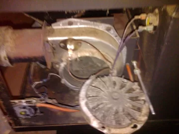

    If this is of any help, I just cleaned the exhaust blower and convection blower on an EF2i.
    Exhaust Blower
    You buy a 6" round gasket before removing. The gaskets fall apart very easily.
    Remove the nuts and unclip the wires and remove the fan
    Vacuum inside the exhaust plenum
    Use a small wire brush to really clean the blades.
    Use a putty knife or razor blade knife to scrape under the fan blades.
    Use Spray Graphite from the auto parts store to make the blades smooth and they will hold less dust and be easier to clean next time.
    Put the new gasket on the bolts in the stove.
    Mount the blower and screw the nuts on and clip the wires back. AC on the wires so it does not matter which is which.

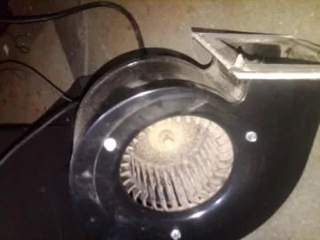

    Convection Blower
    Remove the bolts and unclip the wires. Gasket can be reused.
    Clean the dust off the squirrel cage blades with a cue tip and alcohol or MAV cleaner from the auto parts store.
    Mount blower and screw in bolts and clip wires back on. AC on the wires so it does not matter which is which.
    Assure nuts and bolts are snug but do not over tighten.
    Vacuum out the entire inside so you do not breath in the dust. That is the air that comes out of the heater tubes!

    See pics below
