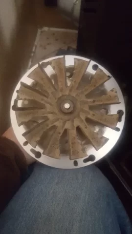

I have a 2006 enviro empress fs, it's been a pretty great stove for me until recently. It had a hard time starting lately. So on a warmer day, I shut it down, tore it all down, as far as I could get the chamber. This is the very best I could have done. It works better, then I shut it down. Restarted it before bed, nothing, just the number 2 light on, and the combustion fan was frozen, won't turn. Bought a new fan from fleabay installed it, and I still get the number 2 light on. Instead of vacuum, I'm getting pressure from the hose. It seems the motor spins reverse from what my old one spun. I can't confirm because my old fan won't do anything. Am I missing something? Swapping the wires made no difference.

Going by my pic, should new motor spin clockwise, or counter?

I thought by looking at the fins, it would spin the other way, but then again, that's why I'm here asking lol

I tried closing it part way, different places, still the same. The new motor spins clockwise. But to compare my blade to others online, mine looks backwards. I watched the video here about combustion motors, and his is reverse of mine

My old fan still works enough to confirm the motor is turning the same direction as the new one. Blades are identical, but no vacuum.
