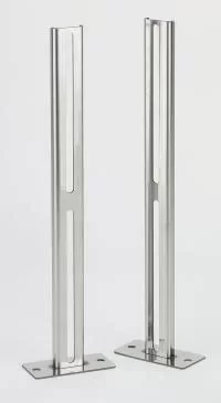

I am looking for some thing like these. I found these in the UK. The adjust out to 15".
If I cannot find them in US I guess I could fabricate a base for a regular wall support to extend out.

I'm looking for the same thing too, but so far no luck. Would probably be easy to make with some galvanized electrical conduit. Maybe something like the lower drawing at: http://www.tpub.com/content/shopequipment/TM-55-4920-212-15/TM-55-4920-212-150075.htm
I'm thinking I could first flatten the center section of the conduit that'll be bent around the pipe, as well as the two leg flanges at the ends. Could even add a separate piece of conduit to be held at the center of the bolt hole and extend down to the wall at 45 degrees to act as a bracket support.
That would work. I am really only concerned with horizontal support with the weight being taken by the roof support so no need here for the 45 degree section.

This is the one I may end up with as you can cut your own length of 3/4" conduit, flatten the ends and drill for bolts.
