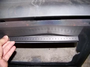

This is why everyone should do a door gasket test even on a brand new stove.
This stove is 10 months old and came pre-bent from the factory. A chimney water leak alerted me to the stove door leak. The bend is impossible to see with the door closed but very easy to see when you remove the primary air slider.
Now I know why I thought I had an overdraft problem.

Yep. It is a good idea to use a straight edge on the all four surfaces where a door gasket contacts the front of the stove. My first NC-30 was bowed in that way at the bottom center of the opening instead of the top like yours. I installed it and burned in it several times thinking EPA stoves were insane until I slapped a straight edge on the thing and found the bow. Went down and swapped stoves with them.
It is discouraging that QA down there isn't checking for this.

Yes it is the Englander 13. It's a good little stove but the quality control needs some upgrades. This is actually the second stove. The first one had a warp on the top rear due to an improper welding process. That one was sent back before it left the pickup truck. IIRC, both stoves passed inspection by the same person.
