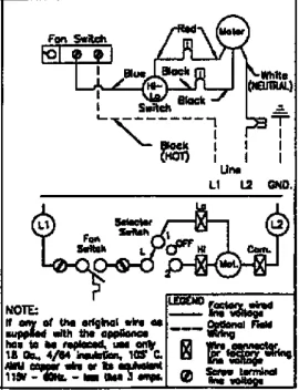

This will depend on how the motor is wired. In Peter's case these motors may have two windings. If so, a motor speed control may not be advisable. I would expect this with the wall furnace fan. That is also a risky one to tamper with. Without enough airflow, the unit may overheat. Not sure about the table fan, but am surprised that it is noisy on low speed. Our 12" table fan is so quiet that sometimes I have gone to bed forgetting to turn it off. But then again, my hearing is not what it used to be.

Attached is the blower motor circuit diagram (sorry about the image quality). I'm guessing a three wire motor will have two windings as BeGreen suggests (?).
