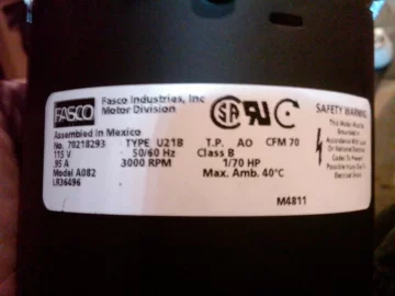

I just got 3 and the tag on the motor says it is 3,000 RPM ! ! ! !
Specs on this motor seem to match up very well with the original specs shown in 1st post
No. 70218293 Type U21B
115V 50/60HZ Class B Type A 0 CFM 70
0.95A 3000 RPM 1/70 HP Max Ambient 40 Deg C
Model A082
LR36496 M4811
You may need to get your drill out. It is the Generic Fasco Combustion Blower Replacement. LOL
