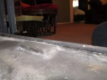

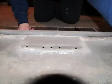

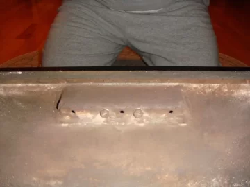

Okay...so while PMing another Lopi Declaration owner regarding my doghouse, I noticed that the lip on the front of my box doesn't appear as a welded seam as it does in the other Declaration owner's pic (large pic). Mine is the smaller two pics. Could this be a manufacturing error and therefore allowing a huge air leak into my stove? This unit is brand new.

Edit: My stove is the first two pics. The third pic is the other owner's stove. I tried Pming him the pics, but for some reason it said that my picture attachment wasn't an accepted file type. Therefore I decided to post here. In case you're wondering, the other owner discovered that his draft was too excessive therefore plugging two of the primary air inlets.

I don't know if that is a manufactures error or not but you could go to a dealer and see if they have one on the floor and compare. You could also ask the dealer to call the manufacture.
My stove has the same seam yours does. That is where another steel frame attaches to it. The reason you do not see my seam is because it is filled with ash. If you follow that seam around and up to the side you can see where it was welded from the outside.

I think you're fine.
Less crotch shot next time, though. :lol:

Lol Bbar...too bad, I was the first pic (black sweatpants). That's a hard shot to get, especially on mine as it sits directly on hearth floor. The Declaration is a squatty beast. It's heating just fine. On cooler days, we've run a morning fire and then one a night. It's gotten the stove room up to 78 on small to moderate sized loads. I'm afraid to stuff it full though.
