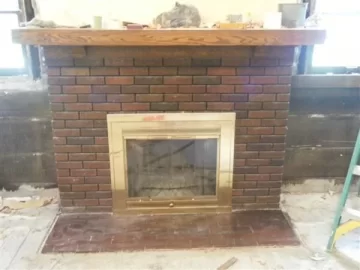

I bought this 1926 craftsman style home a year ago, and I just made it to the living room as far as the remodel goes. I tore up the old hardwood floor, due to animal stains all over the place, and I have 1" x 5" x 3/4" planks underneath. I was redoing the hardwood floors with 3/4" x 2 1/4" prefinished cherry oak. And there is a nice fireplace in the living room, that had built in cabinets on each side of the fireplace, but I had to remove the cabinets to rip up the piss stained floor underneath, and will be re-installing the cabinets after I redo the hardwood floor.

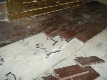

Here's what I want to accomplish. The fireplace has 1/2" thick brick pieces around the floor in front of the fireplace. They aren't secured down anymore, they are all loose. Underneath them looks like a concrete bed. I was wanting to splurge and buy some nice black Granite, because the area is so small, I won't break the bank buying expensive tile. I don't have an Insert installed at the moment, but I was going to get one probably within the next couple years. How deep should I expand my existing footprint so I can be safe to buy any option of insert for my fireplace in the future? The dimensions of the footprint are 72" x 19.5".
As of now, my fireplace is unusable (That's what a fireplace cleaning company told me). Apparently he said that when they put the fireplace in when the house was built, they didn't put the heating tiles or fire bricks all the way down in the fireplace, or some BS like that. Then he told me it was going to cost $3500 for a new insert installed. What I don't get, is that there were ashes in it when we moved here, and this house is 84 years old, so obviously the fireplace has worked for the other people that lived here for a long time. Also, thanks for your input, I really appreciate it!
