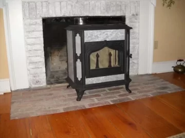

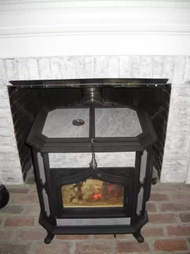

    I put in the Keystone in the Spring of '11 so didn't get to test it in cold conditions until recently, when we had nighttime lows in the teens on a couple of occasions in successive weeks. Keystone did OK but had to work pretty hard trying to keep up in this cabin with uninsulated walls. If I let the room temp drop too much, it was hard to recover, and heating the bedroom was out while trying to recover in the main room. My SIL has a Fireview so I've had a chance to run her stove and get familiar with it. Long story short, I decided to take advantage of the sale that Woodstock is running, and I picked up a Fireview in metallic blue. According to Woodstock's estimates, our square footage is at the low end of the Fireview's range and in the middle of the Keystone's. From what I've seen, I think their estimates are pretty good. The Fireview slid right in as the flue heights are the same on the two stoves. Luckily my nephews, three strapping young lads, were in town for the holidays. :cheese: The stove got here in about three days, and we were able to get it on the hearth without too much trouble. During the next round of temps in the teens at night with a fair breeze, the Fireview tossed enough heat to handle requirements easily. I think that going from a 1.5 cu.ft fire box to a 2.2 makes a noticeable difference in output; The entire stove seems to radiate more from its larger surface area, and runs a bit hotter on the sides and top. Heat keeps coming for a long time. Weather has been mostly mild here, and the larger fire box is also good for loading up on medium-heat woods that I have such as Cherry, and still getting some long burns. Too bad I had to give up the Keystone's big window and the ash pan. It's harder to get a good view of what's going on in the Fireview's box, and harder to see the combustor. I wonder if it would be possible to alter the front panel and put in bigger glass... I'd like to get or make an ash pan that fits inside the Fireview door, to totally eliminate dust escaping when shoveling the ashes out. Some folks don't care for the styling of the Fireview but I like the old-timey look and think it's a good fit in this rustic setting.
    Here's a pic...it really did happen! :cheese:

    Nice install.
    Stupid question...I have been looking at the fireview, but I worry about using the side door in a fireplace installation. Is the stove tucked into the fireplace somehow, or does it stick out a lot?

    That is one nice looking setup! It doesn't get any better than that. The Fireview looks like it was made for that setting, or vice versa. Congrats and enjoy!

    The fireplace is 37" wide at the front, 24" deep, and tapers in to 22" wide across the back. I had the Dutchwest back in the fireplace far enough to top-vent it. I had to push the stove over toward one side of the opening to have enough room to open the side door. That stove had a front door also, but big wood had to go in sideways.
    The Fireview is primarily a radiant stove so I think it's better to have it out in the room where it can do its thing. The sides of this stove radiate huge amounts of energy. Right now, it's sitting so that the back of the stove is flush with the front of the opening. The problem with this is that I can't open the top lid and have it lean back far enough to stay up by itself. I'll have to prop it open with a piece of wood, or better yet put a Tapcon or something on the front of the fireplace that I could hook the lid to. I'd hate to crack a top stone because I knocked out the wood stick holding the lid up. :shut: To pull the stove forward far enough to let the lid lean back as it was designed to do, I'd have to add on to the front of the hearth as I'm right at the mandated 8" front clearance.
    Mine seems to like the fact that the stove sits lower and the radiation off the front stone is down at her level. :)

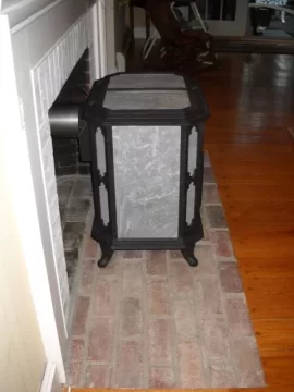

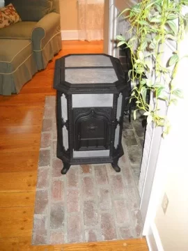

    Here is my install - the side load door opens perfectly and just misses the side of the hearth so I can open it fully. You really want that huge soapstone slab that in fastened to the rear of the stove in the room and not tucked into the hearth. On another note you could also use the rear heat shield to help deflect heat into the room and not rearward.

    Yeah, that's the kind of thing I had in mind. I want everything inside the stove. If you've got sunlight on your stove at certain times you can see how much dust is flying around, not matter how careful you try to be. I'd rather not have to work at being careful. :smirk: That sifter looks useful. I don't like tossing out coals. I've been pushing them aside, building a top-down load with smaller stuff in the front, then dumping the coals on top of the small stuff and stacking bigger stuff in the back... The sifter would make that easier.
    It's probably just my imagination but it seems like cooler room temps don't feel as cool as they did before. 64 normally feels chilly but since I switched stoves, it doesn't seem too bad at all. I can't imagine how this would work except for the walls absorbing the higher radiation and releasing it but it doesn't seem likely it would be very much difference. Bah, probably just imagining it...but I'll keep an eye on it.

    Those Fireview's sure look slick out in front of those fireplaces. Definitely install the rear heat shield, it will help.

    Do you have the required 8" of clearance in the front? Looks like its less that 1.5 bricks wide of clearance. It's measured from the front most protruding part of the cast iron trim at the base of the stove.
    My FV used to really heat up my wood floor in front of the hearth, and I had 10" clearance.

    Yes - I am right at 8 inches (its deceptive - and yes the floor gets toasty) however I have measured it with a temp gun and I am not at all concern - I did place a hearth haif moon rug in front of the fireview and it definitly absorbes some of the heat - so short answer I am at the minimume - I would have went another 2 inches but could not due to the floor joist was right at the 8 inch mark - would have meant a large re-structure project and I felt it wasnt needed.
    BTW - at the time I took these pics I didnt have a hearth shield above the stove - now that area above the stove was a issue - I fabricated a sheild and it worked wonders on reducing heat to the surround..

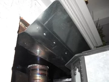

    I am currently wrestling with the hearth/mantel shield issue myself. Would you mind posting a pic of yours and the dimensions you used? Sizing seems to be nebulous with no definitive guidelines. Thanks!

    I looked at your earlier thread, that was one cool looking project you had! You were really lucky the floor joist was not closer to the stove, you just squeaked by to make clearance.
    My hardwood floors directly in front of the FV always got really hot and shrank noticeably, the joints between boards widened. Oddly, the hearth and wood floor in front of my Progress is
    much cooler.

    Jambx, I just saw your post; Great-looking install!
    Installing the heat shield hadn't occurred to me, but I know that back panel gets really warm! Would the heat shield convert radiant energy to heat and convect it off the back of the stove, or would the shield slow down the rate of energy coming off the back and force more energy out the sides and top...or both?

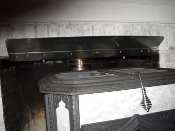

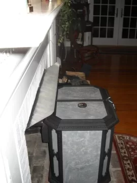

    I also wreasled with this for sometime until I found a super easy way to attatch it - use magnets! What was going to be a temporary sheild (as I was going to get one made out of Copper) worked and looked so great I left it in place.
    Basically I used what I had left of the 22 ga sheet metal I used for the floor - cut it to size (I had use two pieces to make my dimensions), bent it (using a 2x4), a couple of holes and screws later plus two large magnets to hold it agaisnt the lintle and voila!
    The pictures does not really do it justice as it blends rght in at almost every angle.
    My hearth opening was 42 inches - I made the sheild 36 inches wide - 8 inches of a bend - when I measure stright out its 6 inhes from the hearth surround.
    Cost me nothing as I had the large magnets. One day I might make it out of copper but for now this works!

    I have the rear shield on my FV. Hot air does come up out of that space, but some of that must be coming off of the flue, which would also happen without the shield. Also depends on how you run the stove. If you choke it down for a mostly-cat burn, with no flames in the box, most of the heat comes off of the top of the stove vs. the sides/back of the stove. The shield cost ~ $70 a few years ago. . .very reasonable $, like all Woodstock parts, but I think the best bang for your $ would be to block off the mouth of your fireplace, especially since you appear to be handy with the sheet metal. :)

    Do you mean you are closing the bypass at 500F stovetop temp? It should be closed at 250 F stovetop, which according to WS is 500F firebox temp.
    That's a neat shield you made. I like the copper idea, and the magnets! It's hard to find heavy gauge copper any more, and that stuff is expensive!!

    I should have known I would get flagged on that with this crowd - I do in fact close it @ 500 internal (250 external).
    The magnet idea is a great one - it is a very easy install especially since I drilled my lintel for my block off plate and it wasnt pretty (very hard casting) - I also didnt want something so obtrusive and srewed into the mantel. The magnets are the bomb - in the summer all I have to do it pull it off for a more clean look.
    I did find a guy that would bend a piece of copper 22 gauge in my dimensions for $75 - dont ask me why I didnt take him up on it since I think that was a steal.
