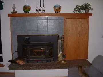

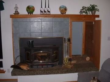

In my last house, as well as the one I'm building now, I put in a "indoor/outdoor" closet, with an exterior door to the outside, and a cabinet style door on the inside. This lets me haul and load my wood from the outside without tracking dirt/snow through the house on my boots. On the last place, the stove was on an outside wall, with the inside door of the closet on the top of the hearth. This really worked well from the convience/loading standpoint, though not so great from a heating standpoint. The new place has the stove located in the center of the house, with the closet located in the laundry room. I'll have to carry wood through the house, but I think it will be worth it.
OK, so who else has done something like this, or what other cool ways have you come up with to solve this problem? In this place, the garage is detached so it wasn't an option.
Hope this make sense.
Bri
OK, lets see if I done figgred how to post pics :)
This is at the old place.
Bri

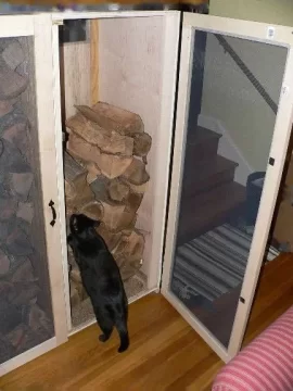

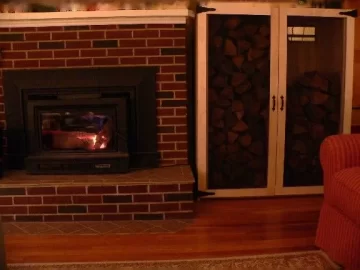

I hated every option I'd seen for storing wood inside near the stove/insert. It was either completely open so bugs can freely escape, or didn't hold as much wood as I wanted, or completely enclosed so the wood didn't get any air flow to dry before burning, or didn't have a bottom so any snow you brought in would melt and you needed to get a rubber mat or something to put under it or put the thing in a pan.
So, I built an Armoire. It's two oversized compartments, with screen doors to allow the wood to dry a bit before burning, each side holds enough to last me about 3-4 days and I made a top section with two smaller compartments to store my kindling, etc. Not realizing how big I’d made the bottom piece, it's about as big a piece of furniture the room can handle. When I put on the top also, it turned monstrous, closed in the room, disrupted our open floor plan and we decided the top had to go. My kindling etc. sits in a sort of magazine rack near one of the couches now. The size of this is 4’Wx5’6"Hx2’D. I planned on using fabric instead of screening for the doors because the fabric would allow air flow and wouldn't allow as much view of the wood, but our interior decorator said that would mess up her balance and counter balance of furniture, fabrics, and wall colors she'd picked for us, and that screening would compliment the decor. So, screening it was.
You can see a big open square cut out in the back on the top covered in screening. That’s for the muffin fans I originally planned to put in. There's lots of 1” holes all through the back covered in screening for increased air flow and there's a white gasket on the inside around the door frame that stops bugs from being able to escape. The doors stay shut with 2 cabinet magnets each. That works well, last winter only 6 bugs found their way out and into the house and only 1 mosquito and keeping the wood inside for 3-4 days before burning was a big improvement.
Nothing extravagent, still needs finish or paint, still needs trim. All made of 3/4” maple finish grade plywood for the outside, and regular 3/4” plywood on the inside to seperate the two compartments. The doors 3/4"x3" maple made by my father (thank god, you have to know what you’re doing to make a screen door corners fit and be strong, and they need to be exact). Haven't figured out yet to stain or paint. As a winter project this year I'll probably complete it. As for the wood, when we're done using our open porch in fall I move it there (our porch is cement). Our porch can hold about 2 cords. Makes me feel like I'm a hick with my wood on the porch but, much easier to load my Armoire from the porch than it is from the other side of my property in winter.

velvetfoot, I didn't have any problem with cold air from the wood closet, the exterior door was a regular wood, exterior door, it sealed fine. My stove was an insert, mounted in an exterior chase, I lost a lot of heat with it. The only exposed area was the front of the stove and a small portion of the sides, some heat came off due to natural convection and a fair amount with the blower, but I lost all radiant off the rest of the stove and pipe. I was real happy with the way the closet worked out. The only other negative is that this was towards my view side of the house, the stove and closet took up potential window space. Can't win.
Oh yeah, I'm not done with the hearth at the new place and already figured out where I screwed up... The hearth is elevated maybe 16 inches, I don't like to bend over too much to load the stove and this gives me a place to sit and warm my back up next to the stove! I should have built a couple of cavities under there open to the front for wood storage-duh. I think I'll pass now, I just finished installing the lath last night and plan to start on the cultured stone tonight, I don't feel like dealing with the demolition to change now. Wish I'd thought of it last week.
The closet looks real nice Brian. Was the outside of the closet incorporated in the chase?
Rhonemas, that is a nice looking installation. I like the approach of being able to have that big a ready wood supply right by the stove. The little closet at the old place held maybe 3 nights worth, at the new place its a fari bit bigger, hoping to last for about a week. Winter days are real short, it would be nice to be able to haul wood on the weekend when I can get out in the daylight and make it to the next weekend. We'll see.

Yeah, it is mounted on the front face of the chase, the door was cut down (or the bottom cut up if you want to think of it that way) such that the outside was about like that inside door, though somewhat taller. Worked real well.
The new one is full height outside, the narrowest steel door I could get, I think 22 inches?? On the inside I'll do a small one like that old one, below the door will be a seating area for taking off shoes/boots, etc in the util room. Not ideal, but I think it will be fine. It gives me a place to set the log carrier.
