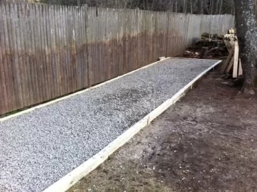

    Finished up my firewood storage area this weekend and I'm proud as a new papa. Thought I'd share some photos.
    This area is 32x6, enough for two rows of 10 pallets [3x3]. The plan is to have three six-foot high rows that run the length, with space in between each row. Should be good for about six cords.
    When we bought the house last summer, the previous owner had four rows of wood stacked right up tight to the fence, with no space in between and blue tarps on top. Needless to say, the wood was crap. You can actually see where the outline on the fence of where the old wood was stacked.
    I've since moved all of that to sit in the sun out back for the next 1.5 years. In short order I'm going to buy six cords of wood for next winter - hopefully something that will season up quick like Ash.

    Why use the gravel if you are stacking on pallets ?

    I would think the gravel will give some drainage and actually help the pallets last longer.... at least I would thinkit would.

    3x3 pallets are unusual size for those that I come across. Most around here are 40" x 48".
    a 6' high single row could be a challenge to keep from falling over...atleast with my stacking ability.
    the gravel should help the pallets last longer

    Sweet. Will add a great look to the fence too.
    Gravel a good idea IMO. Less ground moisture & the pallets will last longer.
    Use some rope or twine if you're worried about stability. Lay 2 runs on top of the rows at about 3' level
    & stack on top of the twine. Tie on to the fences every 6 - 8' & let it stick out the front. then tie a stick to it
    to hold the rows from falling forward.
    Looks like you have a good stable base. I don't think you'll have much ground movement.
    Good job, looks great.
    We definitely will need a pictures of the completed stacks. :)

    Stegman, you have a great idea there. I'm assuming you must stack your wood there rather than in the full open simply because of the size of your lot. You have the right idea by leaving space between the rows and I do like the stone under the stacks.
    Stacking the wood that high can be a bit of a challenge but certainly doable. You might try tying the rows together by acquiring some logs that are much longer than the rest so you can lay some that will be in two rows at once. That will add stability to each row. I'd guess if you did that perhaps at the 3' and 5' level those stacks would be very stable. Good luck and please post some pictures when you've completed the stacking. I for one would love to see them.
    Do you plan on staining or painting that fence?

    All you need to do is throw up a lean-to roof against that fence and you got yourself a full blown woodshed.
    That's basicly how I built my woodshed.

    Seeing the picture of that tall fence the OP posted and seeing how he'll be stacking his wood right against the fence anyway, it would be pretty easy option to build a roof off of it. Sure beats doing the tarp thing.

    Thanks for all the feedback.
    Yes, the gravel is to aid drainage so the pallets last longer. Not sure what the shelf life of a pallet is, but I'm hoping a couple of years at least.
    Can't do anything with the fence as I'm pretty sure it belongs to the neighbor. I'm hoping that the marks left by the old firewood stack will go away, but at the very least my new woodpile will hide it.
    Not quite sure how I'll handle the stacks. I'm actually thinking of breaking them in half, so I'd have six, 15-foot long stacks using cross-laid "towers" at the ends. That would help with air flow, too, rather than having three really long rows.
    Alternatively, I was also thinking of attaching vertical pallets on each end and in the middle and using diagonal 2x4s to brace them.
    Carbon - thanks for making my little project seem second rate. ;-)
    I'll be sure to update with photos as I stack.

    I'd give it a coat of water shield or something so it don't rot out. Even paint, only you will see your side.. I believe your side (face) of the fence is yours to maintain.
    Make it look good for you. The wood stacks are sure going to make it look good. that section anyway. IMO

    As far as I know when someone installs a fence you're supposed to place the best side towards the neighbor's side.. To me it looks like it's the other way around..

    If that fence were leaning every which way & threatening to fall over I'd swear it was mine.
    Wood storage area looks good to me and I'm jealous of all those pallets. I count 23 there. Scrounging pallets has been holding up my stacking for weeks. I need 4 to start a Holz Hausen and at least 1 more for a smoker/fire-pit wood bin. Only got 2 so far. Harder to find than firewood for me.
    Also, it's hard to say without seeing it, but I would not be surprised if the wood the previous owner stored under tarp dried much more quickly than green once stacked properly & could be good to go in the fall.
