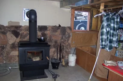

    Mine goes into an unfinished basement, into a wood box, into the stove.
    About 10 days worth (when it's cold)
    1 row, stacked 4'6" high X 6' long 18" splits (roughly 1/3 cord (+/-)
    I empty the stove right before a new load comes in & the ash
    bucket goes out the opening.
    Now using 7 lag bolts with washers to hold the insulated door on but to be a hinged door, it's
    on the "to do " list. when I figure out how to do it. Bolts are a PIA. I use a drill & it's workable.
    But it helps keep the house cleaner.
    Holds 2 trailer loads.
